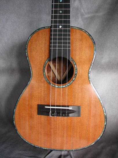

I didn't know so many of you disliked clear pickguards. My thinking is that it won't cover up beautiful wood. Then again, I play the ukulele. Here is a clear pickguard on two sides.
Philip
aka konacat
